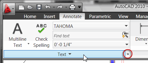

Panels: The panels are the large parts of the Ribbon. This figure shows the Text panel for the Annotate tab.
Panels
The black triangle beside the tab title [A2010], indicates the panel can be expanded to display more tools. The arrow in the corner typically designates a Style dialog box.

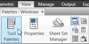

Panel displayWhen the Ribbon is minimized to Panel Titles, you have access to the Ribbon panels, but they're not all displayed at once. When you hover over the desired panel group (as shown in the figure for the Palettes panel of the View tab), then the tools are displayed.

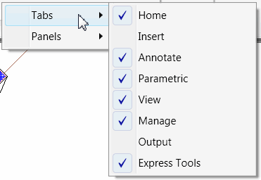

Ribbon Management via the Shortcut Menu
Quick Access ToolbarThe Plot command can easily be accessed in the Quick Access Toolbar (the panel beside the big red "A"), so let's turn off the "Output" tab of the Ribbon.
Right-click on any element of the Ribbon and you get a shortcut menu with two very important items: Tabs and Panels.
At this point, you've probably made the mental leap on where to go from here, but here's one more insight: The Panels are displayed for the current Tab.

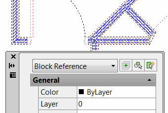

  1. Click on the wall in question, then open Properties. You may see that it is a Block Reference inserted on Layer 0.
    Wall Properties
    If that's the condition you have, Explode that block reference. If you click on the wall after exploding and you see another block reference (with a different name), Explode that block reference.

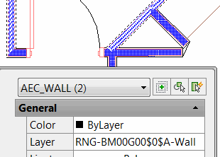

  2. Click on the wall again, open Properties and identify that you now have objects named AEC_WALL. There is a good chance that all the AEC_WALL objects are on a specific layer.

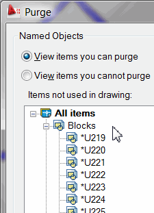

  6. Purge blocksWith all the uniquely named Block References selected, launch the Explode command to explode them down to lines, and possibly hatches.
  7. Run the Purge command and you will probably have several Blocks you can purge, nearly all of them with the unique *U prefix.
Note: By way of comparison, an AutoCAD Architecture drawing with AEC_WALLS, when dismantled per the above procedure, went from 6.6Mb to 2.4Mb !!

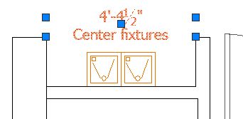

DimensionsThis is totally random, but here's how to create a dimension style with text only.
Instructions to Create a Text Only Dimension Style
  1. Open a drawing with a dimension style you like, then open the Dimension Style dialog box.
  2. Create a New dimension style called "Text Only", then click OK.
  3. On the Lines tab, under Dimension Lines, check the boxes to Suppress Dim Line 1 and Dim Line 2.
    Dim Line
  4. Under Extension lines, check the boxes to Suppress Ext Line 1 and Ext Line 2.
    Ext Line
  5. Make the desired adjustments to the other dimension elements as desired, then click OK, then click Close.
  6. When you add a dimension, you get the same prompts, but all you will see is the dimension text.

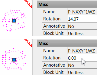

RotationIt's not immediately obvious, but the best way to ‘straighten’ an object is to use the Properties window. This usually comes in handy for Text objects, Blocks, Raster Images; things that have a singular Rotation value that can be edited.
A-B-C Solution
  1. Click on the object.
  2. Open the Properties window.
  3. Enter the desired Rotation value.
