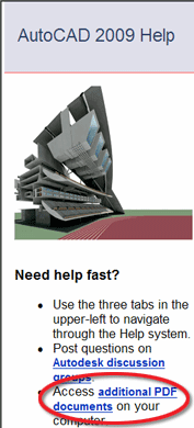

I have written about the oft-overlooked power of the Help files in AutoCAD, so this is one of the places I may go when a new version comes out. In the opening Help window under "Need Help Fast?" there's a link to "Additional PDF Documents". The files themselves are found in the ..\Help folder of your installed AutoCAD 2009, but for those of you who have yet to get the product or would just like to read up on it before installing it, click the topic headings below to open the PDF. I have also included the AutoCAD 2009 Preview Guide for your reading enjoyment.
AutoCAD_2009_Preview_Guide.pdf - Autodesk's official AutoCAD 2009 Preview Guide is another great document I use to get a heads-up on the new features.
acad_new_icons.pdf - There are 32 pages of images of the A2009 toolbars along with an image and definition of each button. Nice to have. [..AutoCAD 2009\Help\newfeatures]
The additional files below are also well worth a look.
acad_cue_cards.pdf - Concise overview of new features including Tips, Features & Variables for each of the following: Menu Browser, Action Recorder, Enhanced Layer Properties Manger, Ribbon, Ribbon Customization, View Cube, Steering Wheels, ShowMotion, Tools in the Application Window, Quick View, Quick Properties, DWFx, Geographic Location, Export Layout to Model Space Drawing. [..AutoCAD 2009\Help\newfeatures]
acad_byw.pdf - Coverage on the extensive 3D and Modeling features extensively refined in AutoCAD 2007 and elaborated upon in A2009. [..\AutoCAD 2009\Help\buildyourworld]

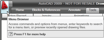

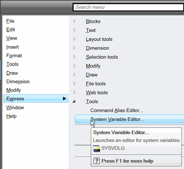

For a reference on what each of these variables controls, click the scarlet "A" in the corner to open the Menu Browser (heaven forbid it should remain across the top as it has since dirt), then click . On the left side of the System Variables dialog box, navigate to the variable of interest to view the description of each value and the default setting. All tip-related variables are saved in the Registry (as opposed to the Drawing).

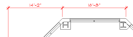

The Continue dimension command enables you to add a string of dimensions to an existing dimension where the intermediate dimensions appear to share a common extension line. You use the Continue dimension command once you have a dimension to continue from. When you click Continue, AutoCAD locates the most recent dimension added to the drawing… and presumes the side from which the dimension will continue.
Question: If there is more than one dimension in the drawing, how do you create a Continued dimension from a dimension other than the last dimension added to the drawing, or the side AutoCAD presumes you want to continue from, for that matter?
Answer: Use the <Select> option.
For this exercise, I have added a single, horizontal dimension.
Specify a second extension line origin or [Undo/Select] <Select>:
Select continued dimension:
