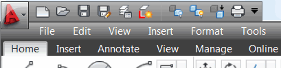

Quick Access Toolbar - Your Best Friend
As you may have noticed, my new Best Friend is the Quick Access Toolbar (QAT). Tool palettes are still immensely powerful, but that QAT is called that for a reason - it's quick and easy.
There are two layer-related things I think would be handy to have up there on the QAT, but neither one can be added by right-clicking on the tool (and one doesn't even have a tool equivalent). Specifically, Layer States Manager and New Layer. Curiously, the one without the default tool - Layer States Manager - is the easy one.
The challenge will be putting a button for a New Layer on the QAT since I couldn't find it anywhere in the Command list. [Note: You may recall that I also covered how to add an image to a tool in Michael's Corner, July 2010 when we looked at putting the firecracker back on the Explode tool!]

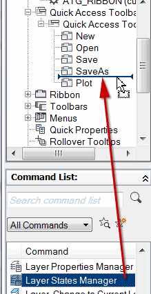

How to Add Commands to the QAT in the CUI
  1. Open the CUI, then expand Quick Access Toolbars, then expand Quick Access Toolbar 1.
  2. Under the Command list, navigate to the command created in the previous exercise - Layer, New Layer - then drag it up and drop it in the list of commands in the Quick Access Toolbar, as shown in the illustration.
  3. While you're in there, add these to the Quick Access Toolbar, too:
    Hide Objects
    Isolate Objects
    End Object Isolation
    Insert SeparatorNote: You can add a separator between commands on the QAT. Right-click on the command you want the separator to go AFTER, then click Insert Separator. Yes, this is contrary to how most other 'insert' procedures operate.

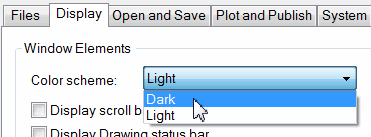

Color Scheme: Light or Dark
Changing color schemeBottom line, AutoCAD users are getting older - aging, shall we say, like a fine wine. I have recently found that a suggestion from one of my users is actually very nice; specifically, the Dark color scheme.
Go to ToolsOptionsDisplay tab, and check it out. The higher contrast found in the Dark scheme is more appealing for your AutoCAD Trainer Guy.

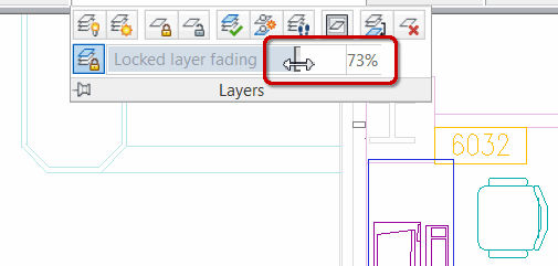

Locked Layer Fading
Lock layerLast month I presented a cool way to lock more than one layer using a Crossing Window… but failed to comment on how to fade the locked layers. With the introduction of the Ribbon, the fade slider is much easier to access.
Note: Locked layers - if you haven't worked with them before - are visible, but not selectable. You can snap to the geometry using object snaps, too, but you can't edit them. This is very helpful when working in floorplans where, for example, you want to move the furniture along the wall, but you don't want to accidently select and move the wall lines when you select the furniture.
Fade slider
How to Fade Locked Layers
  1. Lock a few layers of your drawing.
  2. On the Home tab, expand the Layers panel by clicking on the panel name.
  3. Slide the Locked Layer Fading slider to the desired fade percentage.
Easy!
