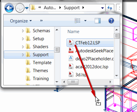

How to Quickly Run a One-Line Lisp
  1. To test the routine created in the above exercise, open any AutoCAD and draw any non-orthogonal line, then draw a circle on one side of it.
  2. Open 'My Computer' (also called Windows Explorer) with Windows key + E.
  3. Navigate to where you saved your .LSP, then drag and drop it into the AutoCAD drawing window. You will see something like the following response on the command line:
    LOAD "C:/Program Files(x86)/Autodesk/ AutoCAD 2012-English/Support/CTFeb12.LSP")
  4. Drag and drop the lisp file
    To run your routine, enter VR (the text after DEFUN C: in your lisp file) and you should see your screen background change. If you have a 3D drawing open, you will see the drawing in the Realistic visual style. That's all there is to it!

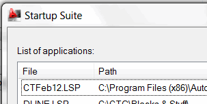

Launching Your LSP from the Startup Suite
LaunchIf you have a .LSP file containing routines that you want to have available whenever you open AutoCAD, add that file to the Startup Suite. On the Manage tabApplications panel you will find Load Application. In the Load/Unload Application dialog box, you will find the golden key: The Startup Suite.
The following instructions are also found on the 'AutoCAD Stuff' link on my website.
How to Add Your .LSP to the Startup Suite
  1. Startup SuiteClick Load Application [Manage tabApplications panel] to open the Load/Unload Application dialog box.
  2. Click the Startup Suite suitcase at the bottom (or Contents) to open the Startup Suite dialog box.
  3. At the bottom of the Startup Suite dialog box, click Add, then navigate to the .LSP files in the ..\Support folder (or wherever you saved that file).
  4. Select your .LSP file(s), then click Open to return to the Startup Suite dialog where you will see the file(s) listed.
    File listing
  5. Click Close, then Close out of the Load Application dialog box.
  6. To make them work, you will need to close and re-launch AutoCAD.

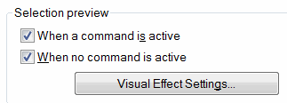

Selection previewI really like the feature that causes objects to 'light up' when you roll your cursor over them, however…
If you have a 3D drawing with intensely meshed 3D objects or blocks, your system may get really s-l-o-w. If that's the case, consider turning off the Selection Preview feature.
Insights
OptionsSelection tab – This is where you have the two check boxes to toggle off the feature, shown in the figure.
Express Tools >System Variable Editor – This is where you will find the variable related to this feature – SELECTIONPREVIEW – along with an explanation of the possible settings, which reads:
Controls the display of selection previewing.
Objects are highlighted when the pickbox cursor rolls over them. This selection previewing indicates that the object would be selected if you clicked. The setting is stored as a bitcode using the sum of the following values:
0Off
1On when no commands are active
2On when a command prompts for object selection
Bottom Line: If you want to toggle off the Selection Preview feature, set the SELECTIONPREVIEW variable to <0>… or create a Lisp routine as shown in this month's opening article so you can toggle it On and Off without typing the whole variable name!

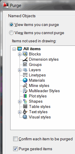

More Powerful Purge Command
PurgeIt was great to see my friends from Autodesk at AU last December. I was particularly pleased to be able to chat with Lee Ambrosius, a guy who I have immense respect for, primarily because his customizing skills are so far above and beyond my own.
As many of you know, the PURGE command gives you the opportunity to 'clean out' any unreferenced Blocks, Layers, Dimension Styles, etc. from your drawing. The potential is that it will make your file size smaller; always a good thing.
Not sure how the conversation came around to this, but Lee was saying that there's also a Command line version of the Purge command. When you type -PURGE (keeping in mind the hyphen is the golden key here), you see the following list of options:
Enter type of unused objects to purge[Blocks/Dimstyles/ Groups/LAyers/LTypes/MAterials/MUltileaderstyles/Plotstyles/SHapes/textSTyles/Mlinestyles/Tablestyles/ Visualstyles/Regapps/Zero-length geometry/Empty text objects/All]:
Of particular importance is the option for Regapps (Registered Applications). For a more complete review of the implication of registered applications, see this review regarding performance issues with excess unreferenced regapp IDs from the Autodesk Services & Support site.
Bottom Line: If your system is running slower than normal, try this:
Command: -PURGE
Enter type of unused objects to purge[Blocks… ] R
Enter name(s) to purge <*>: [Enter]
Verify each name to be purged? [Yes/No] <Y>: N
No guarantee, but that may just help your drawing move along a bit quicker.
Thanks, Lee!
