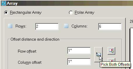

Array by Example
When creating a rectangular array, you can graphically specify the X and Y values using an existing pattern.
Instructions to Graphically Specify the Rectangular Array Offset
  1. Launch the Array command (ModifyArray), then click the Select Objects button and select the objects to be arrayed.
  2. Specify the number of Rows and Columns.
  1. Click the Pick Both Offsets button.
  2. Pick the diagonally opposed points that define the spacing as well as the direction for the pattern. As shown in the example, the pattern from point 1 to point 2 indicates the array is to be created up and to the right.
Note: When picking the two points for the offset, the points specified can be anywhere in the drawing.
