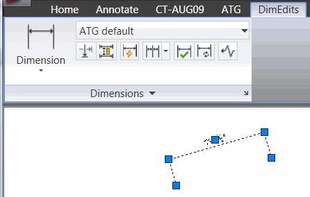

  7. To test your new tab assignment, create a Linear Dimension, then click on it. Your Ribbon should now display a tab reading DimEdits… that has no panels!
Per the Ribbon catch-phrase above, we will now need to add a panel to our DimEdits tab…
Instructions to Add a Panel to the Contextual Tab for Dimensions
  1. Open the CUI, then at the top of the list under ACAD, expand the Ribbon node.
  2. Annotate - DimensionsExpand Panels, then right-click on Annotate - Dimensions, then click Copy.
  3. PasteDown under Partial Customization Files, expand Ribbon, then Tabs, then right-click on your DimEdits tab and click Paste to paste the Annotation - Dimensions panel onto your tab.
  4. Click OK to save your changes and close the CUI.
  5. To test the addition of your panel, click on the dimension… and you'll see the Dimensions panel included on your DimEdits tab!

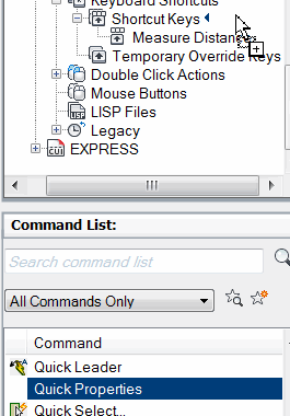

  2. In the Customizations pane, expand Partial CUI Files, then expand Custom. Now expand the Keyboard Shortcuts node.
  3. Under Command List, drag the Quick Properties command up into the Customizations pane and release it next to Shortcut Keys to add it to the listing. (If you have been following my column recently, you may also have Measure Distance or Quick View Drawings in that list, assigned to F1.)
    Note: If the recently added command does not initially appear in the Shortcuts pane (in the upper right quadrant of the CUI), you may have to OK out of the CUI, then re-open it.
  4. Shortcuts paneIn the Shortcuts pane next to the Quick Properties command, click in the Keys column to display an edit box, then press F4 and press <Enter>. You should now see a green checkmark in the column preceding the Distance command name.
  5. Click OK to close out of the CUI. You will now be able to toggle Quick Properties with F4, rather than going down and hitting the QP (or icon).

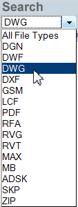

  • Even if you set the File Type to DWG, you may still see a broader range of file types returned for your search.

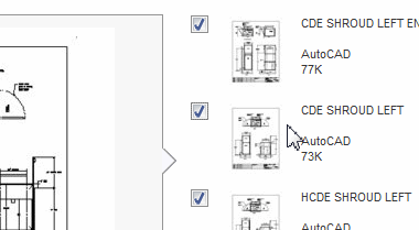

  • To download the content, click the Details link in the listing of file types.
  • Hover over the image of the drawing for a larger view.
  • Check the box for the drawing(s) to download, then click the Download Selected button at the top of the list.
  • After accepting the (to be expected) ‘Terms and Conditions’, your browser will probably prompt you to Save or Open the file being downloaded. I selected three drawings and the zip file contained all three.
Selecting drawings
