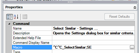

  6. Properties Panel
    Modify the Name, Description, and Macro as shown in the figure. The macro reads (not case-sensitive):
    ^C^C_SELECTSIMILAR;SE

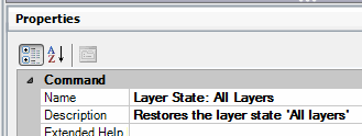

    Properties
  3. Under Properties, give the button a Name and a Description similar to that shown. The description is essentially the ‘Tool tip’.
  4. In the Macro, delete what's there, then enter the following:
    ^C^C-LA;A;R;"ALL LAYERS";;;

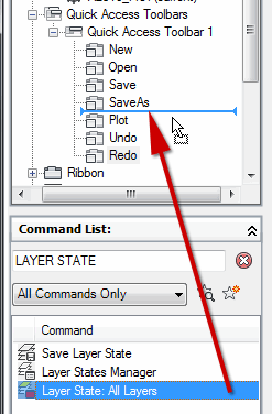

  7. Drag and dropTo add it to the Quick Access Toolbar, drag your command up into the list of commands under the Quick Access Toolbar 1 header, as shown in the figure.
  8. Click OK to apply your changes and close the CUI.
