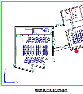

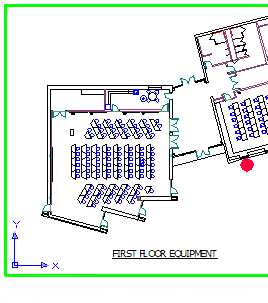

Since there are always at least two working environments in all drawings… Model Space and at least one Layout… sometimes we need to get objects from one location to the other.
Formerly found in Express Tools, the Change Space feature is now on the Modify menu (albeit relegated to the bottom). In the first figure, there is text in Model Space that should be the label for a viewport in the Layout.
Caption in model space Caption in paper space
Instructions to Change Objects from Model to Paper Space
  1. In the layout, go into the viewport in which you have objects to change over to Paper space, then launch the Change Space command.
  2. Select the objects to change, then press <Enter>. You will then see a prompt something like this:
1 object(s) changed from MODEL space to PAPER space.
Objects were scaled by a factor of 0.00146276561534557 to maintain visual appearance.
(Yep, it's pretty important to scale that out to 17 point accuracy…)
