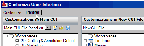

The Customize User Interface (CUI) has a quirk or two, but once you find out what they are, you can manage quite nicely. In the case of exporting your custom toolbar, you need to have somewhere for the toolbar to go before you can send it there. That ‘somewhere’ is a customization file - a new CUI. The procedure given has been successful in transferring toolbars between AutoCAD 2008 and 2009 (LT versions included).
Insurance Policy Statement: Export AutoCAD 200x Settings. The process of exporting a toolbar involves the Customize User Interface. Prior to modifying the CUI, it's always a good idea to have a back-up, just in case you encounter "unexpected results". To that end, I want to remind you about Export AutoCAD 200x Settings [June 2007]. This utility can be found from the Windows Start button, then . The result is a .ZIP file such that if you gom up the menus in the CUI, use the Import utility to put Humpty Dumpty back up on the wall.
Memo: The following instructions are based upon you having a toolbar to transfer. To create a new toolbar, take a look at Michael's Corner, January 2006.
At this point, you have a .CUI containing a single toolbar. The CUI file can obviously contain lots of additional customization elements, but the point of this exercise is to be able to transfer the toolbar to another system. The next few steps show you how to do just that.
Bottom line, I would prefer that you customize a tool palette which has far and away more potential than a customized toolbar. However, if you're going to customize your toolbar, at least now you know how to transfer it from system A to system B.

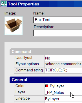

Once again, one of my customers came up with this idea, so during training we implemented it. Several years ago (June 2004), I took a couple months to cover some cool Express Tools, one of which was the routine to enclose existing text with the shape of your choice: Circles, Slots, or Rectangles. []. The Facilities Planning team at Lawrence Berkeley Labs found that routine very entertaining, so we automated it.
Memo: The following instructions take you through the setting up of the properties to automate the "Enclose Text With Object" routine. Since the procedure requires the selection of text objects (and since it's not real easy to create a simple routine that knows when you're finished selecting), after creating the button to run the routine, you will need to select the objects FIRST, then click the button.
TCIRCLE;;R;;
The name of the command is Tcircle. I selected six text objects, then ran the command. The following is sequence of prompts you will get when using this command along with comments regarding the characters in the above macro.
Command: TCIRCLE
Initializing…
Select TEXT, MTEXT or ATTDEF objects…6 found
The first semi-colon presses Enter for the selection after launching the command…
Enter distance offset factor <0.3500>:
Second semi-colon for the offset factor prompt…
Enclose text with [Circles/Slots/Rectangles] <Circles>: R
You could use R, S, or C in the macro, then the semi-colon after your choice…
Create rectangles of constant or variable size [Constant/Variable] <Variable>:
The last semi-colon is to accept the default size of "variable"…
Creating Rectangles…Done.
6 Rectangles created.
To test the button, select several text objects in your drawing, then click your new button and all the text you selected will be enclosed with the requested object type!

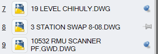

In A2009, I had yet to investigate the purpose of that push-pin used in the Recent Documents list displayed when you clicked the big red "A" (technically known as the "menu browser".)
As many of you know, the File menu/Menu Browser retains a list of the last nine (9) drawings you opened. As it turns out, Dave was opening drawings and noticed that when you click the pushpin for a drawing in the list, it won't let that drawing "drop off" the bottom when you have opened 8 additional drawings since you opened that one. It will stay in the listing until such time as you un-pin it!
