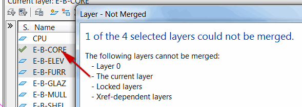

  • In certain situations, a dialog box will display regarding the current layer condition which is preventing the translation (shown here).
    Layer not merged

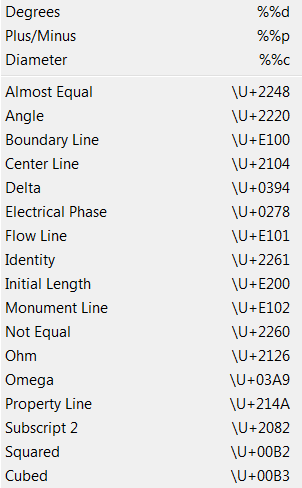

Code listThe AutoCAD users at Gerdau Ameristeel in Knoxville, TN kept me on my toes a couple months ago. One of the cool text features we came across was the way to put symbol characters—found in the shortcut menu of the Mtext editor—into Single Line Text. It's rather obvious, but it didn't occur to me until those guys asked about it.
To see the list of available Symbols, launch Mtext, then right-click in the Editor and hover on Symbol to display the list of available symbols that can be added to Mtext.
How to Add the Center Line Symbol to Dtext
  1. Set your desired Layer and Text Style to be current.
  2. Launch Single Line Text.
  3. Specify your start point, Height, and Rotation.
  4. Enter \U+2014, then press [Enter] twice to complete the text entry… and you see the Centerline symbol!

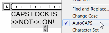

AutoCAPS in Mtext
AutoCAPSMy buddy, Ben Senior, passed this one along to me, and it truly is a curiosity. Most conditions that are set from a shortcut menu or from a dialog box have an equivalent variable; not always, but there are a rare few which don't… and this is one of them.
Right-click in the Mtext editor, then turn on AutoCAPS. Even if your CAPS LOCK is off, you still get capitalized letters.
Even more disturbing, this setting is saved in the Registry. That means AutoCAPS will be the condition in all future drawings until such time as you turn off that setting. So now ya know.

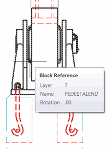

Block referenceWhen collaborating with others, their drawing may have a block that you would like to use in future drawings.
One approach would be to add the block to a tool palette, but in the case of my friends at Gerdau Ameristeel, they needed to make adjustments to some of the machine part blocks for US compliance.
Solution: Wblock.
Briefly, the Wblock command [Write Block] has a dual purpose. The most common use of Wblock is to create a .DWG from selected entities in the current drawing, (see Michael's Corner, June 2006, or p. 103 in The AutoCAD Workbench, 2nd Edition).
The other use for Wblock is to create a .DWG from an existing block in the current drawing. This is where they got the term "write block"; you are writing a block definition to the disk as a .DWG file.
How to Create a .DWG from a Block
  1. First, to optimize the application, click on the block in the drawing that you want to turn into a .DWG. This is the trick I learned from the guys at Gerdau.

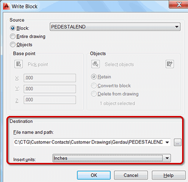

  2. Launch the Wblock command by typing W to open the Write Block dialog box. Notice that the name of the selected block is already in the dropdown list at the top of the dialog box.
  3. Under Destination, click the ellipsis (browse dots), to open the Browse for Drawing File dialog box.
  4. Navigate to the desired folder, enter a name for the resulting drawing, then click Save. You will be returned to the Write Block dialog box.
  5. Confirm the desired Insert Units, then click OK. You will see a very brief flash of a small window in the upper left corner of your screen as the .DWG is being saved.

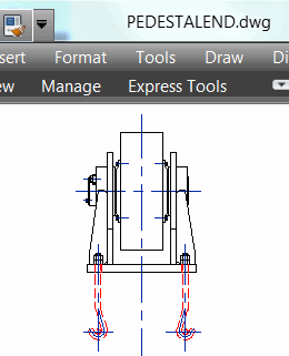

The new drawingYou now have a physical .DWG that consists uniquely of the geometry of the block in the source drawing.
Note: Any block geometry that was on a layer that was frozen when the Wblock command was used—such as the blue Centerline layer shown here—will still be present in the final .DWG since it was originally part of the block when it was created. Just because the layer was frozen didn't make it any less a part of the block definition.
